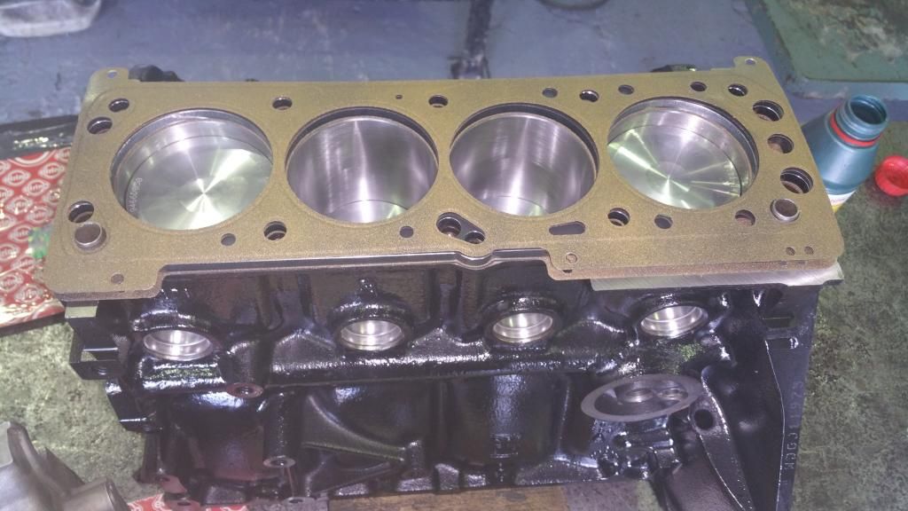

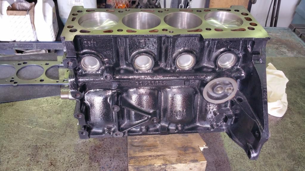

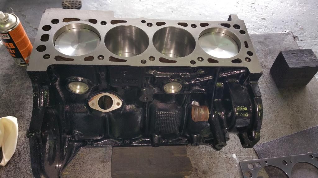

 Post subject: Re: Corsa engine rebuild

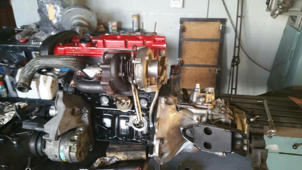

 Post Posted: 01 Dec 2014, 15:42
Joined: 14 Aug 2014, 21:02
Posts: 25
Location: Paarl
few pics
corsa gsi turbo 170kw
 Post Posted: 01 Dec 2014, 15:45
Posts: 25
Location: Paarl
 Post Posted: 01 Dec 2014, 17:54
Joined: 11 Sep 2007, 15:30
Posts: 910
Thats a very think compression plate you running. Did you double check you compression ratio again?
Posts: 25
Location: Paarl
10 days later and still driving lekkker. engine was a success. now its waiting for dyno to see the results
